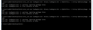

I am using TPS25750 with BQ25792 for USB Type C PD charging. I  understood that, this combination can work without any firmware. But when I connect Quick Charge adapter(peak volt is 20V) the voltage from it is still 5V.
I have referred TPS25750 EVK and found Application customization tool. I am not able to generate any programming files from this (other than .bin file)
I have given option to connect TPS25750 to our host processor through I2C interface. I have referred SLVUC05 document. This document is referring "patch F509.04.02 for TPS25750"
1. How to change the configuration from 5V to 20V so that maximum power of 60W can be achieved ?
2. Is configuration change required for changing the power consumption? And how to configure TPS25750 without using EEPROM and Application customization tool?
3. Can you share if you have any source code to access TPS25750 through I2C?
