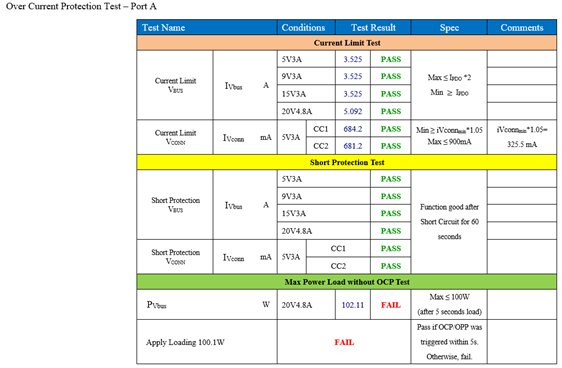

The customer went to GRL for testing, no matter whether the PD is set to 96W or 90W, its OPP will exceed 100W and the protection will be activated at 106W.

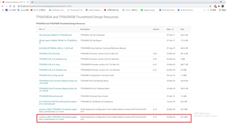

Could it be that the Firmware Tool "TPS65983 Thunderbolt Application Customization 4_14" cannot manually set the PDO over 85W?
Maybe it is manually changed to 96W, but some protection mechanisms have not been changed. Please help confirm whether PD 96W can be modified through this version of TOOL?

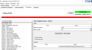

Our firmware switches have default settings. With an output of 96W, you will have 4.8A of current at 20V. This will select PP_EXT current limit (detailed on page 15 of the datasheet). This should select setting 14 for your current limit. Setting 14 has a max of 5.529A, so it is expected behavior for this current limit to exceed 100W at its high end.
In order to check which current limit is being programmed, I can check the switch setting. Can you read the register 0x68 before you apply the short and let me know the result?

2、Thunderbolt 3 certification must test OPP (the specification does not exceed 100W, and the output must be stopped within 5 seconds when it exceeds 100W) Can TPS65983B do it?
3、The results of GRL test 90W and 96W are the same Fail.

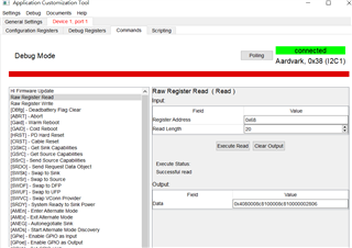

You can use the GUI tool in debug mode to do a register read and then follow up with me with the data. The 90W test has the potential to have a max current allowed of up to 98.3W, depending on the setting. Please check this register and let me know the result.
Emma
Hi Emma:
I can't get the GUI tool to read the data in the register, maybe because it can't be selected through the Raiden interface, so I clicked "Read" and it was disconnected.
In addition, I cannot find the location of the 0x68 register. Which page is this?
For the 90W setting, we tested it in GRL and the result was Fail! The output stops until 106W.

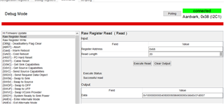

Please use the command tab and use the Raw Register Read field, as shown below.

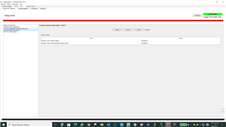

You will have to do an I2C sweep using the type of connector you have (Tiva, Aardvark, etc). It should find the proper address. Then enter debug mode. https://training.ti.com/tps6598x-gui-tool-displayport-alternate-mode-debugging?context=1140344-1140208 this video explains more about debug mode.
Emma
You are reading the contents so that we can determine the current limit setting to see if what we are seeing is expected behavior or do we have an issue with our current limiting.

It looks like you aren't connected to anything. Which gui version are you trying?

Emma
Was this for a setting of 96W or 90W?
Also, please read 20 bytes of the register and let me know the result. The relevant bytes are 9-12.
One other question, what value for Rsense are you using?
Emma
Hi Rock,
Can you read all 20 bytes of the register?
And yes you are correct, this is a tolerance issue with the OCP function. Your thought is right here, to lower the power to lower the OCP. Can you try lowering the power offering and let me know your result?

The firmware team is currently evaluating the register values. Their other feedback is below:
For 90W the current limit (w/o any margin) would be 4.5A. This would mean PHV_EXT ILIM code of 14. This code allows ILIM between 4.523A to 5.529A i.e., 90.46W to 110.6W. This could possibly explain the 106W that customer reported.
Can you please try a power setting of 80W to ensure that the setting is setting 12, which has a max power possible of 98.3W?

HI Emma:
When we set PDO=85W, the tested data is 89.6W. (85W products have passed Thunderbolt certification)
There is only 4.6W more, but when the PDO is set to 90W or 96W, the measured data is 106W.
Maybe this is within the error range that you recognize, but because the Thunderbolt certification test does not allow more than 100W, does it mean that I can't use TPS65983B to set the PDO to more than 90W? because the test will exceed 100W.
What we want to confirm is this problem, whether TPS65983B can set the PDO to 90W or 96W, but it can be limited to 100W during the OPP test, if not, please let us know.
I am glad to hear that a PDO up to 85W works for testing. In order to ensure you are in the right range, 80W is the maximum I calculated. Anything above 80W has a risk to be higher than 100W during OPP testing, due to the range in power output.
