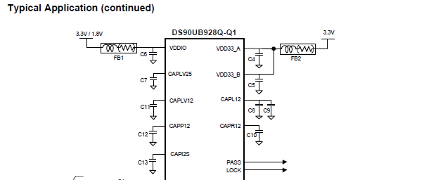

I like to ask about capacitor value of C10 and C12 of below figure.
Datasheet recommends 4.7uF for these 2 capacitors.
Can we change them to 10uF? Is there any concern about increasing capacitor value?

Hello Masaaki,
In this particular case the change is ok and should not negatively effect device performance.
Casey
