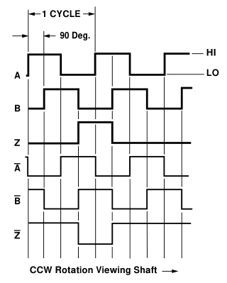

Hi team
The customer wants to convert the output (3 pairs of differential pulse signal: A+/A-, B+/B-, C+/C-) of incremental rotary encoder to single-end signal, which could be connected to the IO of MCU as the logic input. You can refer to the following picture to know more detail about the differential signal.
- Amplitude
- HI:5V
- Differential single: -5V or 5V (For example A+ minus A-)
- Maximum single frequency: 250KHz
- Differential to single-end delay: <100ns
I am not sure whether AM26LS32A is a correct device for this need, if not, could you help recommend a correct device to meet this need? Thank you.
