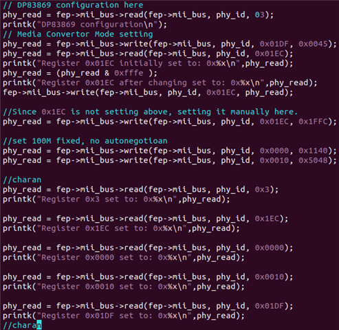

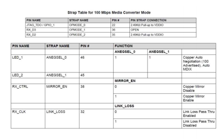

While configuring the registers for 100M Media Convertor Mode we are able to set the following registers to the prescribed values as per datasheet.
1. Register 0x01DF is set to 0x0045 for 100 Mbps Media Converter mode. And we were able to read the same value.
2. Register 0x0000 is set to 0x1140. And we were able to read the same value.
3. Register 0x0010 is set to 0x5048. And we were able to read the same value
But when we set 0x1FFC to register 0x01EC (set bit [0] to 0), the value is not been set. And there is no information available in the datasheet to refer regarding this register.
Hence request to provide a way to set this register and also request for details for 0X01EC register.
