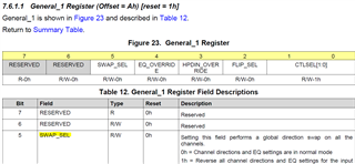

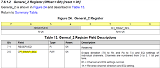

I'd like to know the difference between "SWAP_SEL" and "CH_SWAP_SEL". Is it just the former does a global direction swap and the latter allows you to swap a particular channel?
Besides, the "SWAP" we're talking about here, is it something like the one below? To choose either the upper or lower channel in each channel.
Thanks!
