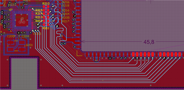

We have designed a 6-layer daughter board with DP83867CRRGZ phy where we mount a SOM with a Sitara AM335x and we are experiencing some issues connecting to our local network.
We used 0R series resistors at the RGMII Rx lines as in TIDA-00204 since there is integrated 50-Ω series impedance, the Link LED is on at the RJ45 connector, but we could not see the device, no IP on the network (There are 33R series resistors on the Tx lines at the processor side on SOM). We tried 22R series resistors at the Rx lines and we noticed that we could establish connection sometimes but not always. When it connects it seems that there is no packet drop.
Could that mean there is an impedance mismatch issue on the board? What else would cause such a behavior? Is it possible some kind of startup condition with the reset signal or power to cause this problem?

-All RGMII signals where routed as asymmetric striplines on layer 3 referencing Ground planes on Layers 2 and 5. Layer 4 was not used in the area under the RGMII signals.
-RGMII signals where length matched with lengths between 55 and 58mm for Rx lane and 61-64mm for Tx lane.

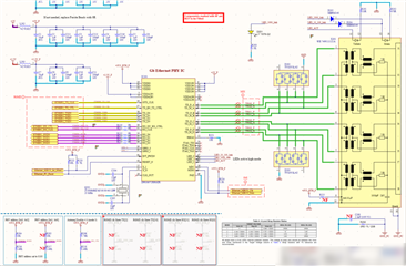

I am also attaching the schematic with the phy connections and a screenshot of the layout.

  • Hi Adrian,
    Thank you for the suggestions. I am updating the status after we did some tests with the reset input of the phy because we were suspecting some kind of startup issue.
    We tried different external pullup values (4k7 and 2k7) with no change in behavior so we disconnected it completely from the processor and left it just with the external pullup. Then we noticed that it was working and we could establish connection on every power up, so it seems that internal delay values did not cause the issue.
    Why do you think this would happen? Could it be some kind of undefined state of the reset input or some kind of timing issue that could cause that behavior?

    Can you provide the following information:
    1. Can you provide the register values for 0x006E and 0x006F when the processor is disconnected?
    2. Can you provide the register values for 0x006E and 0x006F when the processor is connected and after the PHY is powered-up?
    3. Can you provide an image of the schematic with the strap resistors included?
    Essentially, I would like to take a look at those two registers in the scenarios where you could establish connection and could not establish connection.

  • Hi Adrian,
    Thanks again for your support. I am attaching an image with the strap resistors on the bottom left that where not that visible in the previous one (As a note, just to be sure there is no misunderstanding, the greyed out ones that refer to the RGMII skew, do not exist on the board):
    As for the register values, I am really sorry but at the moment we unfortunately don’t have access to the processor and software so that we can read them. We are trying with my colleagues to find a way to do it and I will share them with you as soon as I have these additional info available.
    It seems it is possible that the internal pull resistors on the processor are causing some issues
    In the meantime, If that is the case, are there any workarounds we can try with some kind of external circuitry (pull-ups, pull-downs e.t.c.) ?
