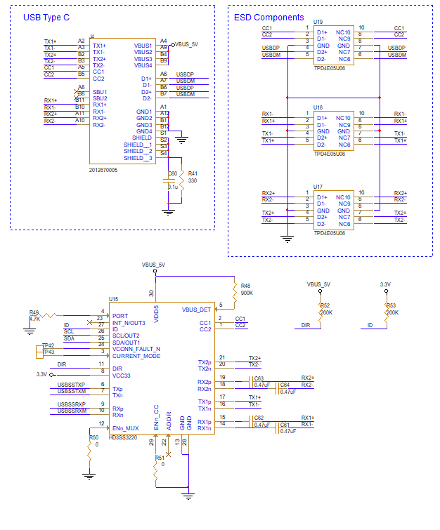

Hi i want to use HD3SS3220 for Typec C MUX IC, device is the UFP model.
And i also add the ESD components.
Is the pin connect is correct or not!?

Sorry, i try to use the other photo server.
Please read as follows.
1: adding 100nf AC cap on TX1, TX2
2: chnge cap C 61/c62/c63/c64 to 330nf
3: pullup DIR to 3.3v , pullup current_mode, vconn_fault to 5v if being used.

And the other question,VBUS_5V need to add the ESD protect component?
Did you have any suggest component!?
