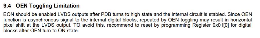

Hi experts,
Some question about 928 to check with you:
1. What's the timing sequence requirement of OEN, OSS_SEL and PDB pin? Should customer pull up OEN/OSS_SEL after pull up PDB? What's the required delay time?
2. Under which condition should customer use LCBL mode? When the STP cable is longer than 10m?
Thanks for your help.
