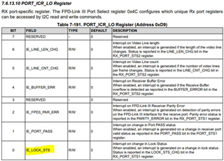

    You can refer to register 0xD9 (PORT_ICR_LO) to configure interrupt generation for changes in LOCK status and register 0x4D to read/clear the interrupt conditions and find the current LOCK status. There is also an interrupt output pin (INTB pin 6) which can be configured to generate interrupts through register 0x23 (INTERRUPT_CTL_REGISTER).
    It is also possible to configure GPIO for LOCK, or send interrupts. Each GPIO pin can be programmed to output data. You can look at GPIO1_PIN_CTL (for example) and set GPIO1_OUT_SEL to 100 (RX Port Lock Indication). And then select the GPIO1 Output Source Select and Enable output. In output mode, the Lock status can be read through an oscilloscope.

    You can refer to Section 7.5.9.2 FPD-Link III Receive Port Interrupts in the UB960 datasheet for the correct sequence to enable/clear interrupts from the Receive ports.
    For the GPIOs, you can refer to Table 7-37 to Table 7-44 in the UB960 datasheet to configure each of the 8 available GPIO. Since there are 4 Rx ports and 8 GPIO pins, there are more than enough GPIOs to cover each port. You can configure GPIO for LOCK by setting (bits 7:5 = 100) and selecting the corresponding Rx source in (bits 4:2).
