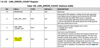

I am trying to understanding the best way to monitor LOCK for the 954. Can you please help with the questions below?
  1. Below are the registers and pins I have identified for the 954 to look for LOCK/loss of LOCK. Are there any others I have missed?
  2. Is there any way to latch a register or bit if loss of LOCK occurs?
  3. Is there any way to configure an interrupt to the SoC if loss of LOCK occurs?
