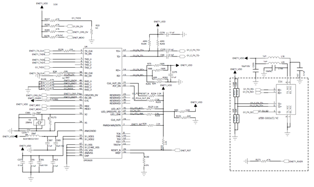

DP83620 can work in 100BASE-TX mode ,But can not work in 100BASE-FX mode,The 16h (PCSR) register is 014B。The schematic i as below。I didn't find any problems。
Can you please check if the fiber mode is getting enabled? You may check register<0x16>[6] for that. Also do make sure that SFP used supports 100BaseFx and its wavelength is correct for it to be received by the link-partner.
Vikram
The SFP can work with DP83640. I read the register<0x16> is 0x14b,That's all correct.
Just to rule out the link-partner, can we try linking two 640 boards? Also is required Fx mode, correctly selected : half/full duplex?
DP83620 can work after wirte 0x2100 or 0x2000 in register 0x00. although I read register<0x00> is 0x2100 but it must write it.
This issue help me to identify the register<0x16>[ is right. But I do'nt understand I read register<0x00> is 0x2100 but it must write it then DP83620 can work 。
