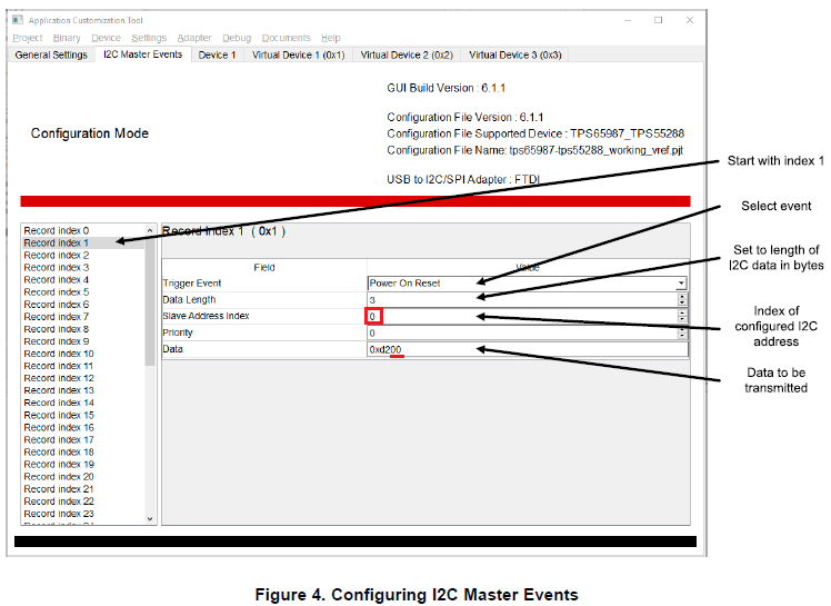

Regarding Figure 4, I believe the value of "Slave Address Index" will be added to the rightmost bytes of "Data".
If we set 1 for "Slave Address Index" and 0xd200 for "Data", we can access the register of I2C address=1h.
Is my understanding correct?
Yaita
  • Hi Yaita-san,

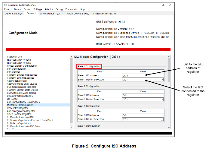

    You will put the slave address in a different register, register 0x64. In this app note in register 0x64, the Index 0 slave address is 0x74. And there is a typo in this figure. The data length should be 2, as there are two bytes of data in the data section. If you probe the I2C lines with an I2C decoder like Saleae, you would see the following:
    0x74 0x00 0xd2
    Emma
    Do you refer "Slave 1 Configuration" is selected if we set "Slave Address Index=0"?
    If so, I also believe  "Slave 2 Configuration" is selected if we set "Slave Address Index=1".
    Yaita
  • Hi Yaita-san,
    You are correct, the indexing of the slave address start at 0. For your example, it looks like this:
    Index 0 = Slave 1 Configuration
    Index 1 = Slave 2 Configuration
    Emma

    By the way, you referred there is a typo in Figure 4.
    0x74 0x00 0xd2

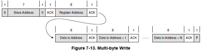

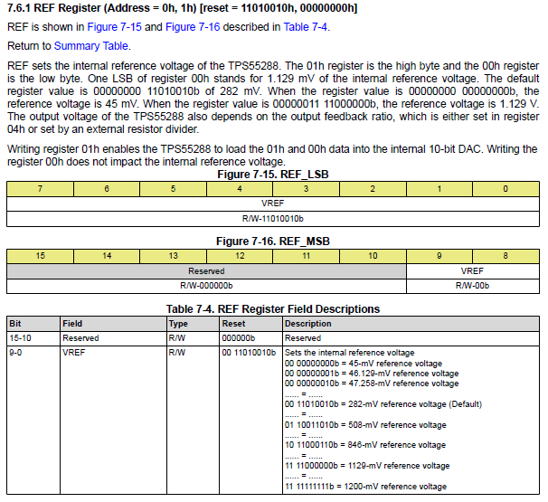

    I think it is not a typo because TPS55288 supports Multi-byte Write and REF Register's address is 0h and 1h.
    What do you think about it?
    Yaita
