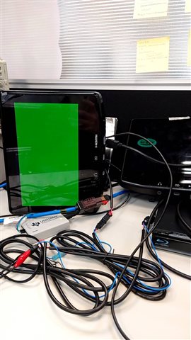

Hi
In our application DS90UH949 is connected to DS90UH940.
We build 150 pcs and 3 pcs out of them got issue that will happen randomly.
The symptom is that randomly, at power on, the screen will display green screen as shown below. At power on, we can see video display correctly for a very short period of time, after that we saw the pass pin (pin 7) of DS90UH940 blinking then the green screen appears. After the green screen appears, the DS90UH940 pass pin come back to high and stay at high without blinking, however the green screen keep there. We need to reset DS90UH949 to get correct video
I had also dump the registers values of 949 and 940 when green screen happen as the below attachment. Would you help have a look what might happen?
