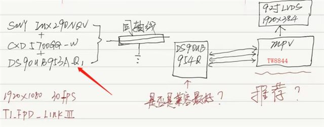

Our customer wants to use DS90UB953 and DS90UB954. Could you please help check if the TW8844 can use as the MPU? Please see the block and datasheet as attachment.

If you can verify for certain that the SoC is compliant with MIPI DPHY spec version 1.2 and MIPI CSI spec version 1.3 then the 954 will work with it. The 954 supports up to 1.5Gbps/lane with up to 4 lanes per CSI port. It would be good to verify with the SoC manufacturer whether this CSI interface is supported.
