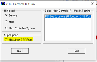

Customer replace TUSB8041IRGCR  with TUSB8041ARGCR directly on the board, but it doesn't work(no signal out), while TUSB8041IRGCR  can work well.
What change should do when replacing  TUSB8041 to TUSB8041A? please advise.

  • So the TUSB8041A works in normal conditions, but not for USB signal quality testing?   For USB 3.x signal quality testing, the TUSB8041A prevents unexpected entry to USB compliance mode on the downstream ports per the USB 3.1 specification updates.  You will need to enable compliance mode entry on the downstream ports of the hub using the XHCI HSETT tool from usb.org.  Let me know if this does not answer your question.

  • Please download the latest version from the usb-if:  https://usb.org/document-library/xhsett-x64
  • 我们使用这个工具只能测到USB2.0的信号,请问USB3.X的信号质量要怎么测试?
  • Please select the highlighted option to place downstream ports in compliance mode:

  • 这个tool只能发USB2.0 TX compliance mode, USB3.0的test mode需要CP0和CP1两种mode,目前这个tool没有,也发不出来superspeed信号。
  • The tool enables only compliance mode on the downstream ports of the hub.  Compliance mode must be enabled on the downstream port of the hub, then the hub port must detect rx terminations and when polling fails, the compliance pattern will start.  Please check the CTS for the scope / test fixtures you are using for more information on how to take the eye diagram.
