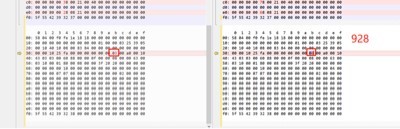

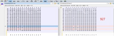

My customer use UB927 pairing with UB928 in EE head unit, and now they meet one black display issue. This is issue is occurred occasionally and hard to reoccur.
What I have tested and result is as follows:
  • UB928 enter pattern mode, pattern is normal;
  • UB927 enter pattern mode, display is black display;
I initially think UB928 enters AV mute mode, and I write below code to UB927 to verify, it seems no work. So could you kindly help me check below code is right or not? If it is not right, what is the right code?
If UB928 don't enter AV mute mode, what cause this happen? Could you kindly tell me how to debug next? Thanks!

  • Hi Jiawei,
    Did you disable the 928 patgen before you attempt to enable patgen on 927? Can you please provide me the register dump file? I can't see with the snapshot captured.
    Aaron
