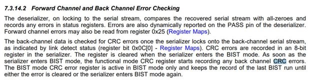

Can we use register 0x25 to read forward channels CRC error ?
Datasheet seems to said register we use use register 0x25 to read forward channels CRC error, would you confirm ?

Hello PYTsai,
section 7.3.14 talks about BIST Mode. If you are using BIST, then yes, you can use register 0x25 for counting BIST errors.
CRC errors are only a function of the back channel. So, CRC counter can be found only on the SER.
