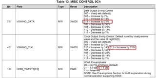

Hello Sir:
Can we meet this three functions by H/W setting in pin strap mode?
I checked the datasheet but cannot find out answer.
Please help to provide recommendations for us.
Thanks a lot.

Hi Statham,
VSWING is controlled by VSADJ in pin strap mode. You can reference Figure 1 for typical values.
6dB pre-emphasis is not available in pin strap mode.
