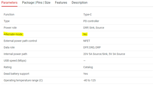

    1. The part you recommended (TPS25750) explicitly states that Alt-Mode isn't supported:
      Is it possible that was a typo?

    Let me fill in some details here then answer your questions. When implementing Type-C the the initial connection for USB and other alternate modes are dictated by the CC/PD controller over the CC lines. CC controllers control where and when Vbus is sourced to the sink. PD controller do the same but also use PD messaging to start negotiation of  different alternate modes. This is required for both source and sink to enable their internal USB-C muxes to the correct modes to establish the DP link. One key point to understand is that TUSB564 is only a redriver mux and is used to connect the physical path of DP source to the DP Sink and improve signal integrity in the link. It is not directly involved in the connection discovery process that occurs on the CC line through PD messaging. As your design exists today, a connected DP source has no way of knowing your design supports DP alt mode since a CC controller is being used therefore the source assumes this is a USB only application (defined by USB-C spec).
    1. My apologies this was a typo, please refer to TPS65988 to get in the right ball park. I do not fully support the PD controller portfolio, mainly USB/USB-C redrivers. for further question I recommend posting a new question using the TPS65988 PN.
