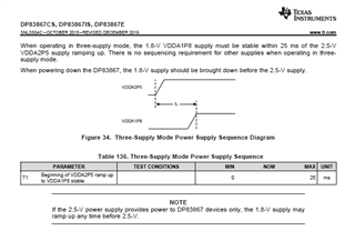

we are using the DP83867ERGZT. On the power sequence for the DP83867 in three-supply mode, the datasheet says if the 2.5V is only
Powering the DP83867 then the 1.8v my ramp up any time before 2.5v.  But, then is says the 1.8V must be stable within 25ms of 2.5V.
So, can we still Power 1.8V before the 2.5V if we have other parts using the 2.5V?
Why do we want 1.8V stable within 25ms of 2.5v?
