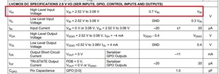

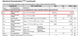

What is the amplitude requirement of the clock signal input from PIN18 (GPO3/CLKIN) of DS90UB913? There is no description about it in the datasheet

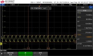

According to the description in the figure below in the datasheet, the IO voltage used in our design is 2.8V, and the clock amplitude must reach 1.96V, but the 1.225V clock amplitude system still works normally in the actual test.
