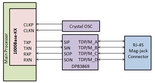

  • Hi Nikhil,
    As per your input we are planning to use DP83869 IC. Could you please verify the below attached block diagram of Ethernet interface and please provide your feedback.
    Vyshnav Krishnan
  • Hi Nikhil,
    I kindly request you to provide your valuable input on the block diagram.
    Vyshnav Krishnan

  • Hi Vyshnav,
    This block diagram looks correct using the Fiber interface between the 1000Base-KX device and the DP83869. However, I want to reiterate that this is not a typical use case and performance between DP83869 over the 1000Base-KX interface has not been characterized. Performance will not be guaranteed by the datasheet, though this configuration should work given voltage output swing specs are met on both sides. Please perform your own evaluation.
    Please let me know if you have any further questions. Else, I will close this thread.
