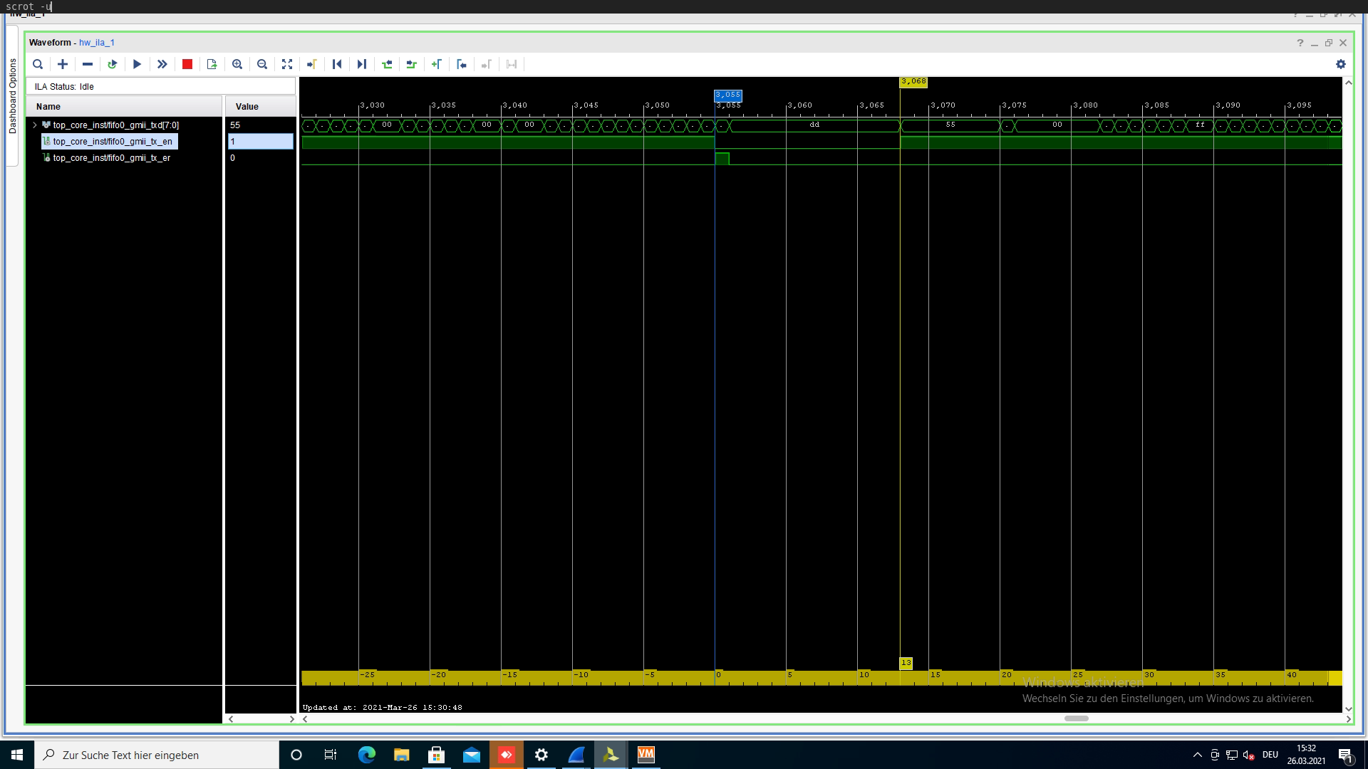

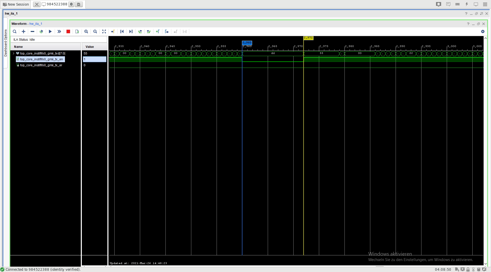

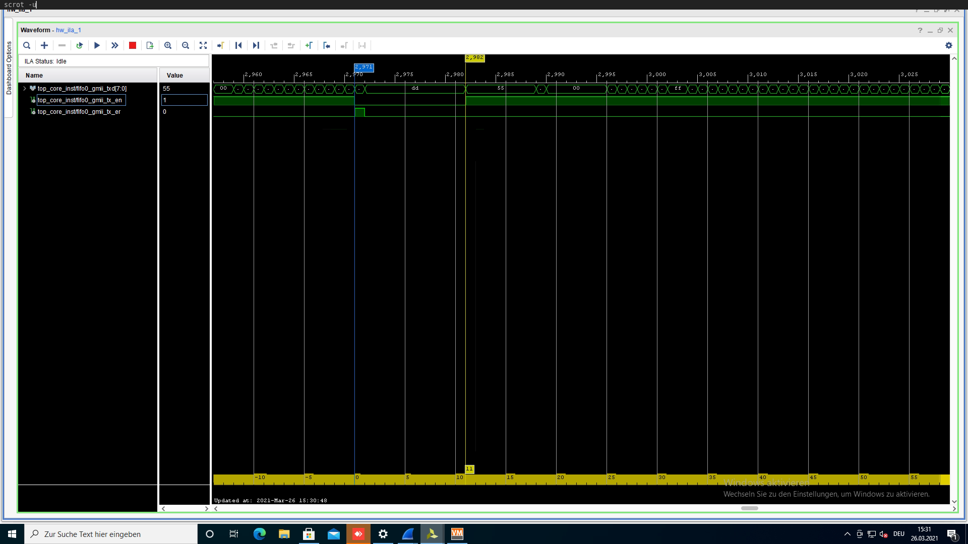

I'm interfacing DP83867CR in RGMII mode with Xilinx Spartan7 FPGA. RGMII traces on PBC are length/impedance matched without added clock delay. Inside FPGA RGMII is converted into GMII using IDDR primitives.
I'm expiriencing a verry strange issue, where when sending ethernet frames with even number of bytes everything works fine. In contrast when sending odd sized frames the RX_CTRL signal is behaving strangely. It can be seen in pictures below.
Even sized frames.
Picture above shows Xilinx logic analyzer with even sized frames, inter frame gap is 12 and RX_CTRL is sampled correctly.
Two pictures abowe show the same situation, just with odd sized frames. As shown gmii enable signal is deasserted before packet end, and the error signal is asserted.
Also inter frame gap is 11 cycles and 13 cycles repetitevly, never 12.
