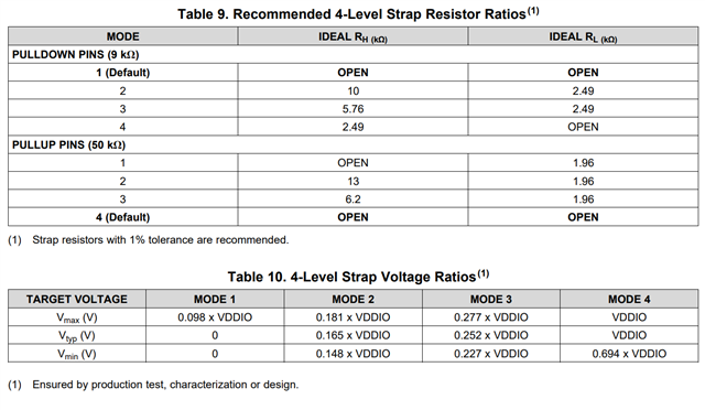

DP83822I: 0x467 Cannot truly reflect the hardware configuration
Part Number: DP83822I

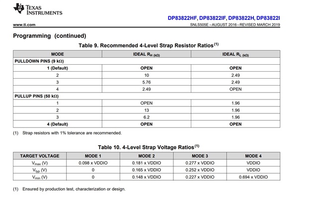

My boot strap is mode 3. but I read the register 0x467 bits 5:4 is mode 0.

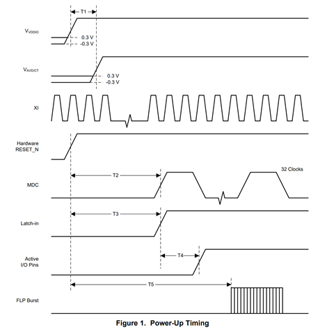

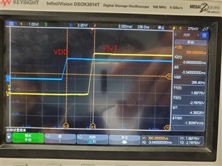

    On the hardware, can you please check if any of the other pin straps made and if those works.

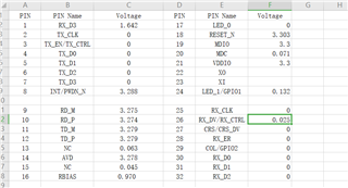

    Can you please measure the voltage for the pin and the resistors values are as below.

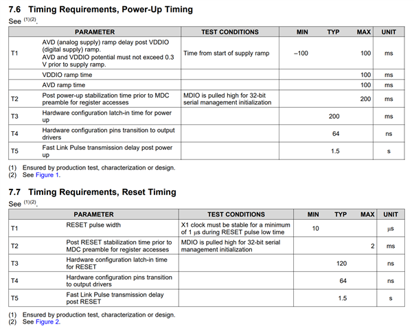

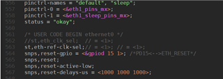

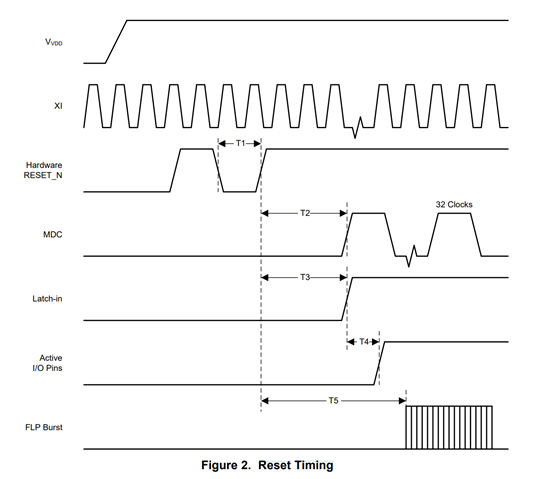

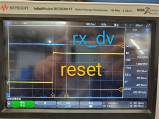

    Can you please check the reset timing.  If the reset is controlled by a pin, can you please do a hard reset after full boot and follow the recommended timing.

  • thank you . I will do it.

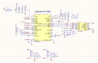

  • Are you online. Can you send me your mail address. Thank you very much. I cant upload the picture, its strange.
  • Hello
    Please use insert -> image/video file
    Click upload and select the image .
    I attached the file in a similar way.
    Sreenivasa
  •  Sreenivasa : Its too easy, "upload" is grey...RX_DV choice is Mode 3.  I use this source code to read address. The result is .

    Thank for the file. The scope picture is not clear, is it indicating the pin strap level?
    The 0x467 status is 2001 meaning RX_d0 and LED_0 ( reserved) pin strap is configured. Can you please check the same.
    If possible, please share the schematics for review.
    Also did you have a chance look into the below that i mentioned in my previous thread
    Sreenivasa
  • Hello Sreenivasa :
    Good morning, Thank you.
    Reset time is 800us. The oscilloscope has been used to confirm it. My dts is follow this picture.
    PINS voltage is
  • Hello
    Thank you for the mail and good day to you.
    I looked at the schematic and measurements and have some questions
    Measurements:
    I assume you measured the voltage after the device came out of reset.
    The Pin straps are latched during reset. Can you place the device under the reset and measure the voltage.
    Schematics
    I see that you connected the VDD to pin straps before the caps and connecting to vddio after the caps. I would assume the VDDIO supply ramp up would be delayed due to the caps.
    The power supply needs to be table when the device comes out of reset to latch the strap configurations.
    You could do this by
    1. for testing, can you increase the reset to > 20ms or more and test. Based on the results you could optimize.
    Alternatively
    2. You can do a hard reset once the host has completed the boot assuming the power supply is stable by that time.
    Sreenivasa
  • PIN PIN Name Voltage PIN PIN Name Voltage
    1 RX_D3 0 17 LED_0 3.2
    2 TX_CLK 0 18 RESET_N 0
    3 TX_EN/TX_CTRL 0 19 MDIO 3.295
    4 TX_D0 0 20 MDC 0.071
    5 TX_D1 0 21 VDDIO 3.295
    6 TX_D2 0 22 XO
    7 TX_D3 0 23 XI
    8 INT/PWDN_N 3.288 24 LED_1/GPIO1 0.004
    9 RD_M 3.29 25 RX_CLK 0
    10 RD_P 3.29 26 RX_DV/RX_CTRL 0.833
    11 TD_M 3.29 27 CRS/CRS_DV 3.226
    12 TD_P 3.29 28 RX_ER 3.225
    13 NC 0.063 29 COL/GPIO2 3.223
    14 AVD 3.278 30 RX_D0 0
    15 NC 0.692 31 RX_D1 0
    16 RBIAS 0.000  32 RX_D2 0
    reset time is 130ms, The phenomenon is the same. Tks, Regards

    Thank you for the measurement, the measured voltage across RX_DV seems fine.
    Can you please check if your are following the below timing and also toggling the reset as shown below in the reset timing after the power-up timing is complete.
    Sreenivasa
  • Hello Sreenivas:
    Thank you. I have a questions. I measured the reset time. The MDC time(T2) is 31ms.  How to measure Latch-in time(T3). Maybe T3 is just equeal to T2. That's too short a time.
  • Hello
    Agreed.
    Sreenivasa
  • Hello Sreenivasa.
    Let me just make sure,   Time is too short?
    And How to measure Latch-in time(T3).
    Thank you.
  • Hello
    This is an internal timing, please ensure T2 timing is followed. please check the same.
    Sreenivasa
  • Got it. Is our time is too long, Thank you!
  • Hello
    Good to know.
    Sreenivasa
  • Hello Sreenivasa:
    Good day to you.
    The specification of 'max 2ms' seems very strange to me. it seems a strange design as puts difficult timing requirements onto a typical linux MAC.    Our picture is:  Ohh, the "upload" button is not found. I can't upload pictures.
    Can you explain to me the time of latch-in? How to control?? Thank you.
    [    3.277060] In stmmac_mdio_reset!!!     --------->reset 3.277060
    [    3.363562] libphy: stmmac: probed
    [    3.368963] of_mdiobus_register:230
    [    3.368973] of_mdiobus_register:235 addr=1
    [    3.379409] of_mdiobus_register:244 addr=1 is phy    ------>register phy 3.379409
    [    3.382044] of_mdiobus_register:259 rc=0
    [    3.386884] IN stmmac_mdio_register!!!! 368
    The time interval is 102ms.
    BINGAN
  • Hello
    Good day to you.
    To start with are you able to read the pin straps now? When are you trying to read the straps, during power up or later.
    Regarding the timing
    During power up:
    Ensure the system is in reset_n till power is stabilized. Time depends on the system.
    The hardware latch up time for the straps is 200ms and the MDC stabilization time is 200ms. Please provide a time of > hardware latching time before reading the register.
    Reset (after power up)
    After power up of the system, linux boot up, power supply stabilization, , you can toggle the reset_n for a time > 10us to do a hard reset.
    The hardware latchup time for is 120ns.
    The MDC stabilization time is 2ms. Please allow > 2 ms before accessing the register.
    Sreenivasa

  • Hello Sreenivasa:
    Yes,reset toggle is 30ms.  and wait time is 31ms for control mdio bus. the clock is 25M.
    All are normal, that is, 0x467 is abnormal. I was about to cry.

    Can you remove C97, C99, C101 and C103 and test.
    Have you probed the MDIO signals and do they look good.
    Sreenivaa
  • Hello Sreenivasa:
    Yes.
    The time is too long.Because first uboot, then kernel toggling reset gpio.
    I removed the Capacitors, the result is the same.
    MDIO signal, I can read the phy register. mean it's okay.
