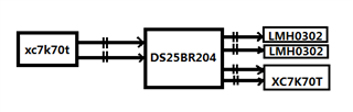

  • Thanks a lot for the prompt feedback.
    We are also looking at the DS25BR204 with 2 inputs and 4outputs. The topology is shown as below. The connections are all through AC couple. Does DS25BR204 could be used in this way? Or do you have other 2 input and 4 output option to recommend?
  • Hi Tess,
    Your block diagram should work fine and DS25BR204 can be used in AC coupled mode as you have shown above. Please make sure you use at least 1uF AC coupling Cap values.
    Regards,, Nasser
