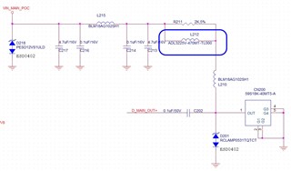

Due to shortage of POC inductor ADL3225V-470MT-TL000 (TDK) for TI913A , do you have any suggestion for alternatives ?

Hello Ian,
I'm not sure I have an exact replacement to the coil in question. If you find something with a similar inductance, DCR, current rating, and temperature rating it may work. I would suggest also reaching out to the vendor for similar inductors and verifying that the network and channel still meet out specifications.
The problem is the network is tested as a whole. So when we suggest a network we tested the whole network to make sure it meets our specs. Where is this network from?
