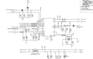

1. Customer doesn't use LDO, pin16 is connected with a 10uF cap to GND
2. Customer doesn't use watch dog, doesn't use RAM watch dog
3. Customer uses AN FD register/Interrupt/Diagnostic Falg Registers
4. Schematic is as below
Could you please tell me if TCAN4551-Q1 pin-pin compatible with TCAN4550-Q1 in this case? Thanks.
  • I mean if both hardware and software 100% compatible? Thanks.
  • Wayne,
    The only differences between the TCAN4550-Q1 and TCAN4551-Q1 are no watchdog or 5V regulator output on the TCAN4551-Q1, and the TCAN4551-Q1 can work down to 1.8V IO levels.
    Everything else on the device is the same. The schematic shared will work, and the software won't need to change.
