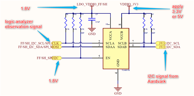

  • Hi Chris,
    Have a nice day!
    Please refer to below channel 2/3, for the first graph, SCLA/SDAA is low with B side connect to GND, but the second graph is abnormal that SCLA/SDAA is still 1.8V.
    Apply 3.3V on B side
    Apply 5V on B side
    attach schematic
    LDO_VDDID_FF/SH and FF/SH_SPI/I2C is from other module, but I measured with digital multimeter, Pin1 and Pin5 definitely should be 1.8V.
  • Hi Jiajia,
    The EN pin is referenced to the B side of the device not the A side. A VIH on the EN pin is 0.7*VCCB. Can you try pulling up the EN pin to VCCB instead of VCCA.
    Chris
  • Hi Chris,
    I will have a try, I need remove the source component which power supply of EN and flywire to EN to supply VCCB.
    I also check datasheet, indeed EN VIH is 0.7*VCCB, but apply 3.3V on VCCB, is about 3.3*0.7=2.3>1.8V, it should not work as well.
  • Jiajia,
    Yeah it is definitely very weird that it worked at 3.3V however there is always a slight threshold when it comes to silicon, however at 5V the device would definitely be disabled.
    Also I see on the schematic that some resistors especially the SCLB/SDAB are DNP. These resistors are actually soldered in right?
    Chris
  • Hi Chris,
    Okay, at the beginning no solder the pull-up resistor, originally I doubt related with it, so I try a couple of resistors, no effect, for the later test, solder 2.2kohm, actually signal has an internal pull-up in Aardvark side, but I'm not sure if a weak or strong pull-up.
    I will try your suggestion, I think it's a good find and hint.
    in datasheet on diagram is as below, so EN should align with host, right? if signal comes from A side, EN from A, if signal comes from B side, EN from B?

  • Jiajia,
    The EN pin is always referenced to the B-side of this device. It doesn't matter what side the host is on.
    It is possible that the LSF device may have had it's EN pin referenced to the A side.
    Chris
  • Hi Chris,
    Thanks, will feedback to you once I do the measurement, do you think we should modify our schematic although 3.3V supply  seems ok, any potential risk if EN fixed on 1.8V.
  • Hi Jiajia,
    If you want to operate the device at 3.3V that is fine. I am not sure if keeping the EN tied 1.8V is the best solution, it is well under the threshold for a VIH on EN so at that point it will probably vary depending on the silicon of each device. Have you tried the EN=1.8V with multiple TCA9617s?
    The EN pin actually has an internal pull-up resistor to VCCB. So I would recommend just leaving R11 as DNP and not populating it. I see that EN is connected to an I2C signal. I'm not sure the capability of this signal. Is it open drain or push-pull? If possible I would not use this signal to drive EN high instead I would only use it to pull EN low and otherwise I would leave it as high impedance.

  • Hi Chris,
    Good day!
    Sorry late to update.
    I connect EN to 5V, issue is gone, your idea is correct!
    For your question: EN is fixed with 1.8V, not I2C signal, network name may misunderstand you.
    Really appreciate for your great help and consistent help, I think we can close this case, thank you and TI again.
