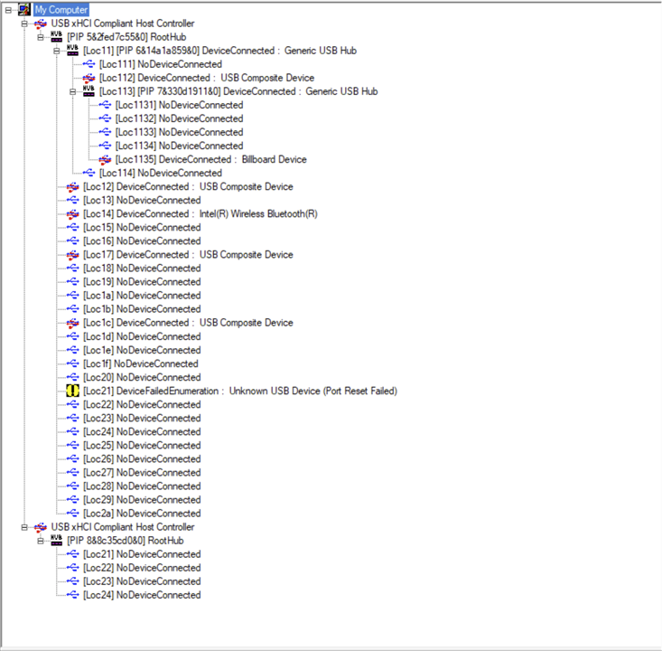

I have a custom board with the TUSB8042A.
Upstream: USB 2.0 and USB 3.0
Port 1 has USB 2.0 and USB 3.0 USB-A
Port 2 has a permanent connection to USB 2.0 to a MCU
Port 3 has USB 2.0 and USB 3.0 USB-C
Port 4 floating
And I have the HD3SS3212I, on the upstream port and port 3 since those are connected to a USB-C connector.
I am running into the issue where super speed is disabled. Pin 39 floating, showing 3.3V high, which indicates that super speed is disable if I'm reading that correctly
How would I enable Super speed.
