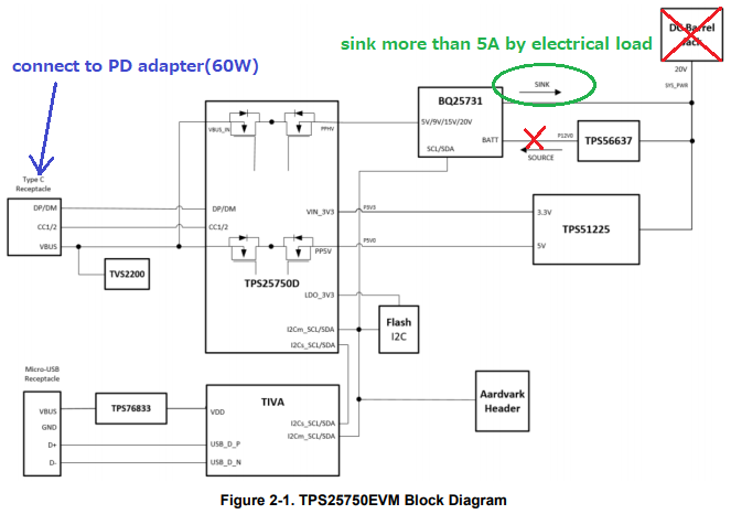

My customer is evaluating the sink current of TPS25750EVM.
DC Barrel Jack isn't connected and external 3.3V is supplied to VIN_3V3.

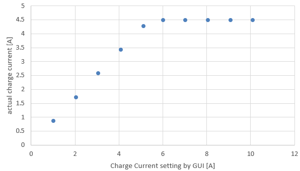

He connects the PD adapter (Anker PowerPort Atom III 60W) to Type-C connector then sinks current from SYS_PWR however he couldn't sink more than 5A.
If he sink more than 5A, SYS_PWR (4.2V) was dropped although 20V is supplied to VBUS.
He set the following in TPS25750EVM Application Tool.
- battery charging voltage: 4.2V
   note) CELL_BATPRESZ: 1cell (=VDDA*0.25)
- battery charging current: 1.024A or 3.072A or 5.12A or 7.04A or 10.112A <- The behavior isn't related to battery charge current.
Can TPS25750EVM sink more than 5A?

  • Yaita,
    The USB PD spec does not allow the system to draw more than 5A from the type C connector; however, it is possible configure the current limit of the BQ25731 to be different from the TPS25750, so you may be able to draw more than 5A of current from the BQ part at the Sink Point.
    The TPS25750 limitation will be at the PPHV point.  This point in the power tree is limited to 20V/5A or any other voltage at 3A by the type C spec.

  • BQ25731 can sink more than 5A current, just set the IIN_HOST register for input current limit. With 5mohm current sense, the max input current can reach 10A max.
  • Hi
    BQ25731 datasheet shows the default value of IIN_HOST is 0010_0000 (I2C address=0Fh), it is 3200mA input current.
    I believe 3200mA is sufficient because the input voltage of BQ25731 is 20V in this case.
    BQ25731 operates buck converter as the following.
    20V -> BQ25731 -> 4.2V(SYS_PWR)
    Do you know why BQ25731 limits the sink current ~5A from SYS_PWR (4.2V) with TPS25750EVM?

  • The USB PD spec does not allow the system to draw more than 5A from the type C connector. Could you isolate the BQ25731 and use BQStudio/EV2400 to access to the I2C bus?
  • Hi Tiger-san,
    Yes, I understand "USB PD spec does not allow the system to draw more than 5A from the type C connector".
    In this situation, BQ25731 operates buck converter as the following so it isn't required to draw more than 5A from the type-C connector.
    It seems BQ25731 limits the sink current ~5A from SYS_PWR (4.2V).
    My customer has TPS25750EVM only so he can't isolate BQ25731.
    I would like to know how to sink more than 5A from SYS_PWR with TPS25750 Application Customization Tool.
    In other words, I would like to know if TPS25750EVM supports the requirement above.

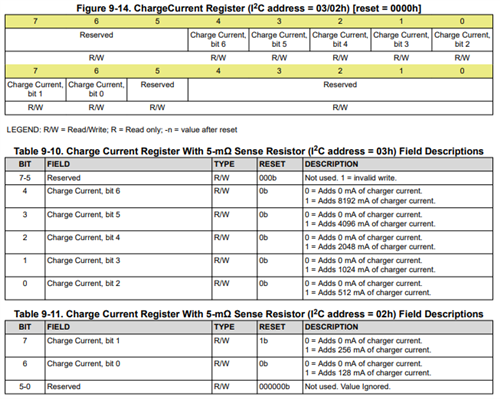

    You can update the charge current register for the BQ25831 to change the charge current after the PDO has been negotiated by the TPS25750
  • Chuck-san,
    My customer directly read ChargeCurrent register of BQ25731 when he set battery charging current=7.04A with TPS25750EVM, then he confirmed the register value is the following.
    03h=0d
    02h=c0
    => 7.04A (4096mA+2048mA+512mA+256mA+128mA)
    So, the issue isn't related to ChargeCurrent register of BQ25731 because it is set correctly.
    Could you look into the issue again?
    Yaita

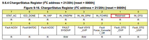

    My customer increased the value of IIN_HOST Register (0F/0Eh) as the following however it shows no improvement.
    2d00(=4500mA) -> 3f00(=6300mA)
    He also confirmed ChargerStatus Register (21/20h) and it shows "8200" when the sink current is restricted.
    Note) He confirmed the register shows "8400" when e-load sink lower current than 4.5A.
    Do you know what the Reserved bit indicates?
    Yaita

  • Chuck-san,
    My customer could increase the sink current from 4.6A to 5.4A when he changed ChargeOption0 Register (0x01) from 0x05 to 0x07.
    The changed bit is PWM_FREQ.
    Why 800kHz is set as default although L=4.7uH in TPS25750EVM?
    BQ25731 datasheet shows 400kHz is recommended with L=4.7uH.
    In any case, he hasn't been able to get the expected sink current yet.
    Do you have any updates?
