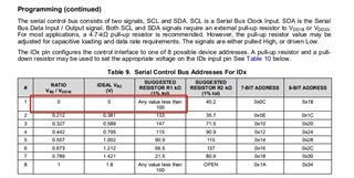

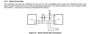

Hi team,
As shown in the following picture, if the IIC address of 947 is set to 0x0C, the datasheet shows that:
R1: Any value less than 100k;
R2: 40.2k;
I'm a little confused with it and I'd like to definite with you, whether it should be
R1: suspended or high resistance;
R2: Any value less than 100K;
Could you please help give some comments?
