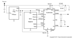

Customer is using TCAN1043-Q1 in their new project and have few questions about SLEEP mode control.
The power supply connection is the same like below diagram in datasheet.
When we enter the SLEEP mode through MCU output high level in EN pin exceed go-to-sleep time.
The power supply for MCU or VIO pin power off as IHN transient to floating output.
Base on my understanding, the only way to exist SLEEP MODE is wake up from CAN bus (wakeup from external system)?
Wakeup through WAKE pin is vaild or not when VIO is power off?
  • Hi Gabriel,
    The local wake up (LWU) feature on the WAKE pin is available even when Vio is not present. This function is dependant on Vsup so it can remain a valid wake source when INH controls the Vcc and Vio supplies. As long as Vsup is supplied in sleep mode, both LWU and WUP wake sources will be active.
    Let me know if you have any more questions.
