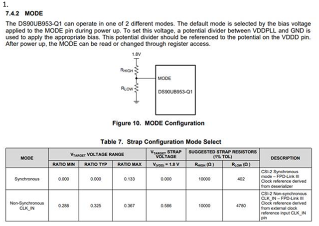

I have a question about MODE in the TI953 specification,

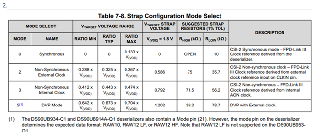

Figure 1 shows the 2018 specification and EVK application resistance values are both 10K and 402R, but as shown in Figure 2 in the latest specification,
Could you tell me which design I should refer to? THX
