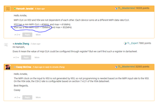

But i can not find a register to configure the mipi clock.
I want to know how can I use the 184MHz mipi clock.
My current matter is the mipi clock isp to 953 is 100MHz,and 954 output clock is 400MHz.
tks

Hello Wangkun,
are you talking about using the 184MHz on the SER or the DES?
On the SER you have no control over the CSI speed since this will be provided from the image sensor.
On the DES, you have only three speeds; 400Mbps, 800Mbps or 1600Mbps. These speeds will scale up or down if you change the REFCLK.
