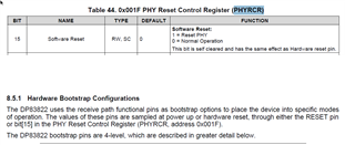

  • Ciao Adrian,
    I will try that for sure, but why  doesn't the device  behave as  indicated in the datasheet  (see picture) ?
    If I wanted to compensate the weak PU at poweron with an external PD, how big can be the PHY GPIO's output current?
    This is important in order to assess the Pulldown resistor..
    thanks
    G
  • Is it possible that I am not writing the PYCR[15] correctly?
    How can i verify that the reset was actually performed?
  • Hi Giulio,
    If the strap settings in the register are different from what you intended, that usually means that the voltage on those strap pins at power up or restart is not the same as the voltage for the mode you want, as specified in section 8.5.1, table 10 of the datasheet. You are free to use an external pulldown to try and hit the target voltage when resetting, but since you stated that the settings are correct on power up, that may be changed with the addition of a pulldown.
    As for verifying reset, one way to check it is to look at RX_CLK. If the reset went through, then there would not be a proper clock on that pin during reset.

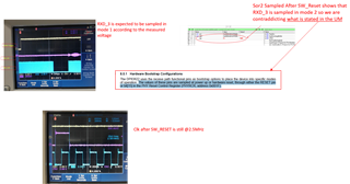

  • Hello Adrian,
    As you can see from the pic,  the RX_CLK is stopping after the monitor GPIO_TRIGGER positive edge ( just before the SW_RST via PHYCR[15].
    Unfortunately, as you can see from the acquisition related to register SOR2, despite the fact that RXD_3 is @0V, nothing changes.
    This behavior is unexpected according to what is stated on the datasheet.
    What are we missing?
    Another question: we are thinking, in a future revision of the board, to separate the reset of th ePHY from the MCU one. The MCU might control the phy reset with a dedicated GPIO. Can you see any problems with that?
    G
  • Hi Giulio,
    I have a few questions:
    1. What does GPIO_TRIGGER do? Does it trigger the register write that resets the PHY?
    2. Would you be able to provide a schematic of your board? You can email it to me if it is something can cannot be shown on a public forum like E2E?
    As for your question, I do not see any problems with that. There are many cases where the RESET pin of the PHY is controlled by a GPIO on the MCU.
    Adrian Kam

  • Ciao Adrian,
    Upon reset (the physical one via reset pin) the value of the  strap is at about 0.5V (because of the presence of the  MCU's WPU). in this condition the phy samples RXD_0 to RXD_3  ( which are the phy's straps with internal PD ) in mode 2.
    When the MCU is operational I remap the relevant GPIO's in input mode without any PU and, as you can see from the  image above, RXD_3 ( but the same applies to the others RXD_x pins) is at about zero. this value is compatible with mode 1 and should be sampled accordingly.
    In the image you can see that the strap is sampled in mode 2 (either by the frequency of the clock and the value of sor2).
    regards,
    G
  • Hi Giulio,
    After experimenting in the lab, it seems that the datasheet is incorrect, and that straps are not resampled using the reset by setting PHYCR[15]. However, resetting through the reset pin will resample the straps, but for your system that is probably not possible. As a result, the best option would be to configure the settings you want through register write after the software reset.
    Since you want RX_D0 to RX_D3 and RX_DV configured to mode 1, that would mean you want the following configurations:
    • Auto-negotiation enabled with all speeds and duplex modes advertised.
    • MII mode with 25 MHz reference clock
    • Fast link drop disabled
    • EEE disabled (on the sent schematic, it seems RX_D1 is strapped to mode 2, which would enable EEE. Let me know if this is a mistake)
    Let me know if I got something wrong. The PHY address does not seem to change between mode 1 and mode 2, so we do not have to worry about it.

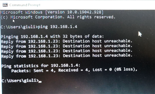

  • Hello Adrian,
    Half good news,
    After the digital restart the phy seems correctly configured to 100MHz Full duplex. Find Below the full set of registers
    We still got some stability problems though and I suspect that the prototype I'm working with (at home) , not in a good shape, cannot go past 10Mb/s.
    Tomorrow I'll verify  the patch with a better hardware and I'll let you know.
    regards,
    G

  • Ciao Adrian,
    I can confirm that the phy can now negotiate 100Mbit Full duplex!!!
    Thank you for your valuable support.
    G
