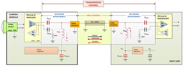

4. Is the arrangement of C(AC_N)+50ohm close to the Serdes end or does it need to be coupled to the Fakra connector end in parallel with the LVDS+ trace?
5. Are there any differences between FPD-LINKIII and FPD-LINK V for the above layout?

    4. The capacitor should be placed near the device but the trace should be terminated through a 50ohm resistor near the connector.
    5. The layout will be similar however there may be different values of AC caps depending on speed and operating mode.  The appropriate values are described in table 8-2 of the 933 datasheet.
