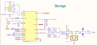

We want to use the TCAN4550-Q1 in one of our products.
So far it is working well, we can send and receive messages but we have a problem with the interrupts - although it looks we configured   MCAN0 on GPO1 correctly, the interrupt line (GPO1) remains permanently high.
We have no clue why - can one of your support team members help us here:
Here is a register dump after receiving a message - all status bits look correct and also the GPO1 configuration is set to MCAN_INT0 output and the  interrupt line are enabled:

  • Hi Sebastian,
    Based on the register dump, it looks like GPIO1 is configured correctly for the MCAN interrupt mode.
    Addr:00000800 - C80204A0
    TEST_MODE_EN     [21]    = 0  - DISABLED
    GPIO1_CONFIG     [15:14] = 00 - GPI
    GPIO1_GPO_CONFIG [11:10] = 01 - MCAN_INT 1 (Active low)
    This output will report interrupts that are assigned to MCAN_INT1 in the Interrupt Line Select register (address = h1058). Currently, it looks like no interrupts are assigned to this interrupt line. Select which conditions you would like to trigger this interrupt line by writing a 1 to the corresponding bits.
    Addr:00001058 - 00000000
    Also ensure that this interrupt line is enabled in the Interrupt Line Enable register (address = h105C). Currently, it looks like this line is disabled.
    Addr:0000105c - 00000001
    EINT1 [1] = 0 - Interrupt line m_can_int1 disabled
    Let me know if this resolves the issue or if you have any trouble with revising the configuration.
    Eric Schott
  • Thanks Eric ! Works perfectly now - the old issue of a C programmer if counting starts at 0 or 1 :-)
