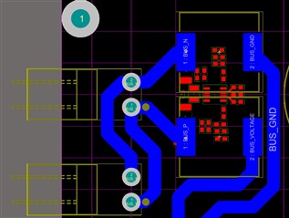

  • Dear Eric,
    Thank you for the replay
    1) if 120Ohm twisted pair is used then:
    What is the impedance on your demo board for lines
    1a) from U6 to R11/R9 (B and A lines), single ended and differential impedance? ( track width is 10mil spacing 15.6mil)
    1b) from R11/ R9 to C11/C9 (B and A lines), single ended and differential impedance?  ( track width is 30mil spacing 45.26mil)
    1c) from C11/C9 to J27 ( B_LC and A_LC lines) , single ended and differential impedance?  ( track width is 60mil spacing 210mil)
    2)is it ok to reference the A/b lies and B_LC/A_LC lines to the same GND?
    3) Regarding the jumper that turns on termination on last slave. is it ok to use a switch on the edge of a PCB and then have long lines ( 1500mils) to the termination resistor? Marked in red on picture below
    David.
  • David,
    1) 120Ohm matches the differential cable/pcb impedance (or 60Ohm single-ended).
    1a) this trace is between the IC and termination and should be low impedance;
    1b) 1c) these routing should match the cable impedance;
    Given the application with long cable, usually the pcb trace is not the dominant factor of signal quality. In your design, you can put the IC as close as to the connector.
    2) the DC voltage at the two sides of the decoupling capacitor (C9/C11) are isolated. They don't share the same ground.
    3) I think it's OK to do so. However I would make the jumper routing as short as possible, otherwise you could create some open-ended 'stubs' on the bus.
    For impedance matching, this app note is a good resource. For stub, please refer to section 3 of this technical note.
  • Dear Hao,
    I looked at the THVD8000EVM  board in altium and:
    1) Regarding impedances
    if i put the numbers from board ( trace width/separation and stack-up details) in the impedance calculator i get
    1a) for A/B track 60OHm single ended and 111Ohm differential impedance ( referenced to L2)
    1b) for A/B track after R10-R11/R8-R9 - 31ohm single ended  and 62ohm differential  ( referenced to L2) -> this don't match 120Ohm diff impedance of ta cable ?
    1c) for A_LC/B_LC track after C9/C11 - 18ohm single ended  and 37Ohm differential   ( referenced to L2) -> this don't match 120Ohm diff impedance of ta cable ?
    2) On the whole second layer is the same GND plane, and you sad that the A/B lines and A_LC/B_LC don't share the same GND?
    David.
  • David,
    Thanks for looking into this.
    1) the EVM was not designed to match the cable impedance. Again compared to 10s- to 100s-meter cable, the PCB trace is negligible. However you're welcome to make the trace impedance matching in your design.
    2) the A/B line is grounded to GND, and A_LC/B_LC is to GNB. The purpose of power line communication is to transmit AC signal and block DC.
  • Dear Hao,
    please can you check my schematic, and tell if some of the components can be removed or need to be replaced?
    Also can you tell in my design:
    1) is it ok to reference B and A signal to GND? And use 60Ohm single ended and 120Ohm diff impedance?
    2) is it ok to reference BUS_P and BUS_N signal to GND or need to reference to BUS_GND? Also is it ok to use 60Ohm single ended and 120Ohm diff impedance?
    David.
  • David,
    Is the power 48V DC? 1) yes, please reference A/B to GND. 2) please reference BUS_N and BUS_P to BUS_GND. Either 60Ohm single-ended or 120Ohm differential works.
  • Hao,
    yes the power is 48V DC , why are you asking?
    Br.
  • No worries. I saw SMA6J48A is used on the power rail.
