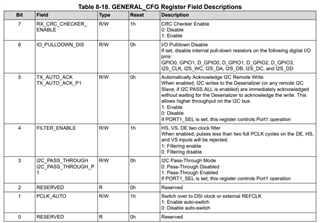

Hi Team,
When a GPIO is being used and connected to a processor, does that mean the 25k pull down is no longer enabled? If so, in order to disable the pulldown, is any change to the default value in the GPIO configuration register enough to disable the pull down?
Thank you,
