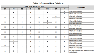

Our customer is configuring DRV2605LEVM-MD thru Arduino and would like to clarify about the value of Register at Section 6.1 of the User's Guide in the link below. The value of Register in Table 4 and 5 are N/A, what would be the command to enable individual and all the channels 1-8?
https://www.ti.com/lit/ug/slou400/slou400.pdf#page=10
