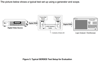

Hi team,
What device does the digital video source use to input signal to the development board?
What kind of signal does the logic analyzer or oscilloscope observe?
The development board is SERDES24-35USB, and the digital video source is VG835.
    The DS90C241 takes in a RGB parallel video source from your parallel video source (VG835). The DS90C124 outputs the same video data on a parallel interface.

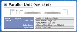

  • Hi Michael,
    There are two question.
    1. Is the "parallel video source" mentioned in the above reply the resource mentioned in the red circle of the attached picture? The picture information is the vg835 manual found on the Internet.

    VG-870B_871B.pdf
    2. Because the vg835 has been discontinued, we found the vg870b to replace it. Please confirm the information in the attachment, that is, whether the vm1816 module of vg870b meets the test requirements of the development board serdes24-35usb.
    It seems that the VM-1816 is compatible with the DS90C241.
    Michael W.
