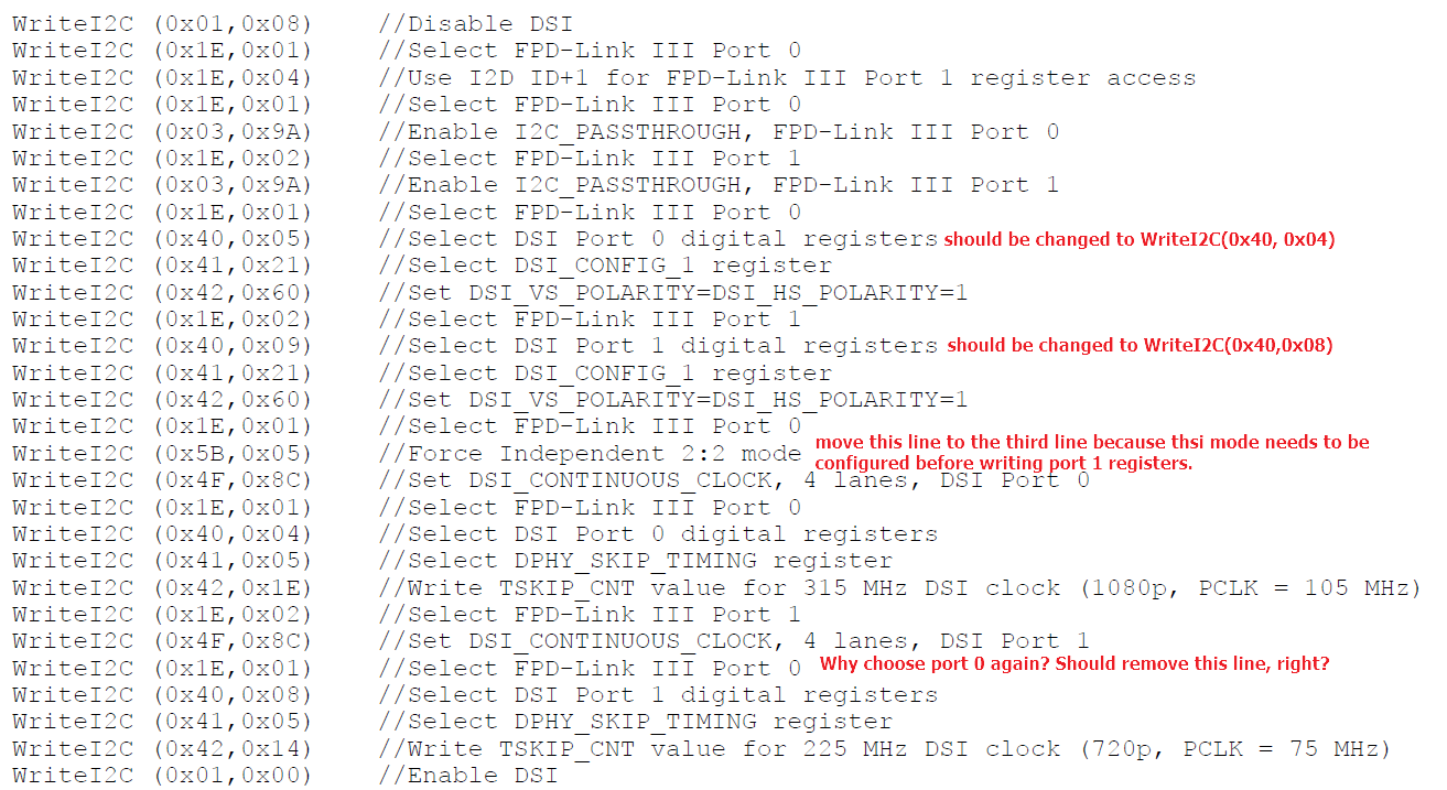

    My question posted yesterday is not about the pattern, and it is about our initial code. I think our initial code in the datasheet have something wrong, so I want to confirm with you.

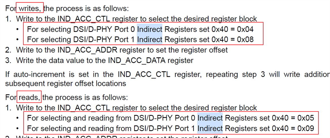

    Please refer to the screenshot of my last post, there are four doubts,
    1. On the ninth line, WriteI2C(0x40,0x05) is a read operation instead of a write operation, but here we need a write operation, so we should change to WriteI2C(0x40,0x04);
    2. On the thirteenth line, WriteI2C(0x40,0x09) is a read operation instead of a write operation, but here we need a write operation, so we should change to WriteI2C(0x40,0x08);
    3. On the seventeenth line, WriteI2C(0x5B,0x05) should be move to third line because in our datasheet, it said 'The device will not allow writing to Port1 registers unless the device is configured for Independent 2:2 mode. Thus, Independent 2:2 mode should be enabled prior to configuring port 1 registers'. Please refer to the first screenshot.
    4. On the Fifth-to-last line, we select port 0 again, which is wrong. We should select port 1 here because port 0 has been configured on the nineteenth line.

  • Hello Sherry,
    For #1 and #2 the code is correct. Bit 0 enables reads but does not disable writes. So with 0x05 you can either read or write the register.
    For #3 the example code is also ok because the write restrictions to port 1 that you are mentioning are related to the FPD port 1, not the DSI port 1. DSI port 1 registers can be written before the part is placed into independent 2:2 mode.
    For #4 it is also ok since this is just selecting the FPD port 0 again but it is actually not configuring anything there. It is just setting the port select pointer back to port 0 for future use.
    By the way, 941AS actually has two pattern generator blocks to allow for independent PATGEN on port 0 and 1 in independent 2:2 mode or splitter modes. This is covered on page 124 of the datasheet. So you can select port 0 or port 1 and then configure the PATGEN parameters independently to drive two displays at once with different timing parameters. I would suggest to try this first before going to the end to end testing with the DSI source.
    Please try this first and make sure that both displays can be brought up using PATGEN with internal timing and internal PCLK from the 941AS. If this does not work, then please post your PATGEN code as well as the panel timing for each panel so we can review and provide feedback.
    Casey
