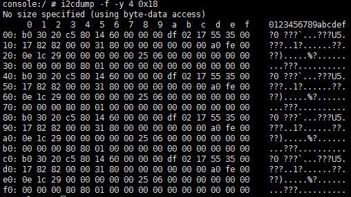

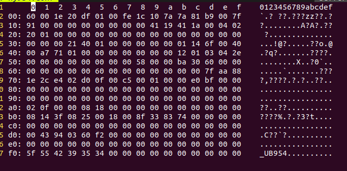

Hi team,
the application is sensor + 933 + 954 +SOC + display. the problem is the display don't have any sensor image. but the 954 and 933 can link, and 954 have output signals to SOC.sensor data type is YUV422, PCLK=92.4M, 1920*720, RAW10.
with the same 954 + SOC + display setting, when pair with 913,  display is normal. Therefore, we think the link of 954+SOC+display is good.
could you help to review and comments ? thank you in advance.
below is 954 reg value, no matter pair with 913 or 933, the 954 reg setting is the same.
933 reg value: no display
913 reg setting, display normal
