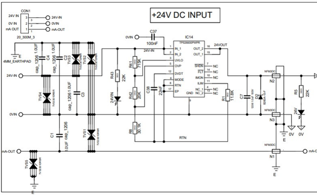

TVS3301: TVS3301 design quiery
Part Number: TVS3301
We have designed a 24 dc input using the TVS3301DRBR for surge protection but when doing in-house testing the component keeps blowing when a 0.5kV surge is applied to the input. I have attached the schematic of the input and wondered is there an issue with how we are trying to protect the input?
