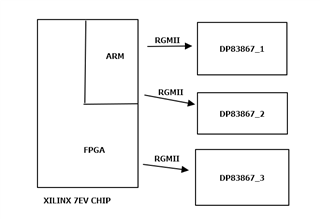

Now,I draw a sch about 7ev(arm+fpga)+3*dp83867.two dp83867 are connected to the ARM side,the other dp83867 is connected to the fpga side.
the three dp83867s can work well at 100Mbps mode,but  can't work well at 1000Mbps mode.I did some experiments as follow:

  • 1、I use an RGMII internal delay in the dp83867.and don't  add delay on the clock PCB trace.the length of clock and data[0,1,2,3] PCB trace is the same.
    2、check the ifconfig,RX receive errors=overruns+frame. Lots of errors,and Lots of overruns.a bittle of frame.
    3、reg 0x32 is 0x00d3,and reg 0x86 is 0x98. reg 0x6e is 0x000c,and reg 0x6f is 0x0000.
    4、 RX_CLK is 125MHz

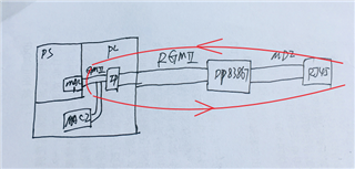

  • HI,
    On the fpga side:
    1、I test the  Far-End (Reverse) Loopback,the link partner can generate the original data,and can receive the data without err.
    2、as following pciture,GMII can be loopback,the link partner can generate the original data,and can receive the data without err.
    3、I think RGMII is ok from item 1 and 2.
    4、At now,we only do some experiments on the FPGA(eth0).and just test the speed of eth1,the2(on the arm).the speed of three eth are same.
    Can you call me to talk about the problem?my number is 18906819845.
    If you are talking about far end reverse loopback, like mentioned in our datasheet, that does not go through the RGMII interface. If you set up a loopback though in the FPGA, then yes, point 3 makes sense. If point 3 makes sense, then I believe the PHY is working correctly and the error is most likely in the software on the ARM/FPGA side.
    Please let me know the results of your delay testing.
    Lysny
