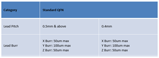

Even though there is no burr or mold flash found on TPD1E01B04DPLR, but we want to know if TI have any spec for burr & mold flash?
This is for precaution for our MP product later in case we found later. If TI don’t allow any burr or mold flash, please also mention about it.
