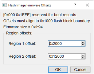

I am using the TPS65981 and I am looking for redundant image of the config file we store for PD TPS65981 in EEPROM for their board.
I found some details has been provided in the section 3.5 of the TI’ SLVUAH7B–June 2015–Revised July 2016. I understood that PD support to store two copy of application code and also run from high region when low region code has error.
I have few queries, pls. help me to understand better.
  1. What will be starting address for each region is it fixed or automatically set while configuration ?  [I thought this was region1 and region 2 as shown below in the configuration tool, is that correct?  How do you verify this in the binary file? ]
