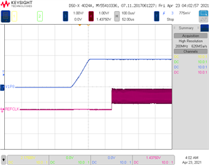

I notice in section 7.4.4 of the datasheet it says: "REFCLK should be applied to the DS90UB954-Q1 only when the supply rails are above minimum levels"
Then it looks like in Figure 55 that REFCLK is being applied before the supply rails are above minimum levels (REFCLK applied as VDD starts to ramp up). What is the correct sequencing?
I also notice the DS90UB954-Q1 I2C does not ACK when I have a 26MHz REFCLK applied. However it does ACK when I remove the REFCLK (REFCLK pin is open). I am using the ASEDV-26.000MHZ-LR-T as a 26MHz REFCLK. I must be missing something in the datasheet - why is it unresponsive when the 26MHz REFCLK is applied?
See a scope capture of REFCLK below. Note the device is operating in VDD_SEL=LOW, and VDDIO = 1.8V.
Nicholas
  • Hello Nicholas, Figure 57 in the 954 datasheet shows a detailed power-up sequence assuming you are using synchronous mode. If not then look at figure 58 for the power-up sequence. As for the REFCLK it must meet the specs given in table 3 which according to your scope capture it looks like it is. Are you able to verify your power-up sequence with the scope showing the power rails and the REFCLK sequence is following figure 57? Regards, Nick
  • Hi Nick. Thanks for the reply, yes I am using synchronous mode. See the REFCLK sequencing below. Note that PDB is pulled high well after this. Still, the 954 is unresponsive when the REFCLK is applied as described in the previous post. Thanks for your help, Nicholas.
  • Hello Nicholas,
    Can you make it such that the REFCLK is available to the 954 prior to PDB going high?  Then check register 0x04[4] to see if it is showing valid REFCLK.
    If issues persist can you get a scope capture showing the actual power sequence?  Show the power rails, PDB, and REFCLK.
    Nick
  • Hi Nick,
    Yes, REFCLK is available to the 954 prior to PDB going high. Note The PDB pin has a 33kohm pull up and 10uF cap to ground (recommended in the datasheet). As referenced in the previous post, PDB is pulled high well after REFCLK is applied. See the zoomed out scope capture below.
    I am not able to check that register (or any register), because the 954 is unresponsive (NACKs) when the REFCLK is applied. The 954 does however ACK and I am able to read registers when REFCLK is removed.
    Nicholas
    Can you decrease the REFCLK Vpp?  It looks like you are slightly above your VDDIO of 1.8 volts which is not recommended in table 3.  Also can you put the I2C lines on the scope?  I want to see if it NACKs or if it is completely unresponsive.
    Nick

  • Hi Nicholas,
    I know if the clock source is too far outside of the spec then the device will not recognize it and should continue to use the internal AON clock.  But I don't believe this is part of your issue.  If you start the device without REFCLK available and apply it after some time.  Try to do register reads before it is active and after.  See if the device can see a valid clock in register 0x04[4].
    Nick

  • Hi Nick,
    Yes, the previously posted waveform captures shows the full sequence:
    1. VDD18 is turned on (VDDIO tracks VDD18 very closely)
    2. REFCLK turns on shortly after
    3. PDB charges slowly and eventually pulls the device out of reset
    I have also tried enabling REFCLK after PDB goes high, and the issue still persists.
    Side note: I noticed that if I FORCE_REFCLK_DET in register 0x02[0] before enabling REFCLK that I can communicate with the deserializer after enabling REFCLK. However, register 0x04[4] and 0x04[2] still shows invalid REFCLK and no lock to the serializer.
    Nicholas

  • Hello Nicholas,
    So first thing here is the internal pull-down on the PDB is relatively strong as you mentioned.  It would be good to try a much lower value on the external pull-up, I think something like 1k - 5k could work better in keeping the PDB voltage above the necessary threshold.
    Another thing to try is to show a similar scope capture as you showed before but instead of showing the enable signal of the oscillator, show it actually oscillating, along with VDD18 and PDB.
    Finally on the one scope capture you shared of the oscillator compared to VDD18, this clock signal appears to have a bit of an offset.  Is it possible that offset is present currently and is causing the clock signal to not go below the VIL threshold?
    Nick

  • Hi Nick,
    I am somewhat skeptical of the deserializer IC on my board. See the device marking in the picture below. There is a "P" in front of the "UB954Q". If I look up "PUB954Q" on TI's part marking lookup, nothing comes up. Have you seen this device marking before and can you confirm that it is a genuine TI part? I'm not sure where our turnkey sourced this part from. I just sent them an email, asking about it.
    Do you have some samples laying around that you can send me? I would like to be sure that the IC is the issue, and not the board/schematic. It would be extremely helpful if you're able to send some.
    Nicholas
  • Ok now we are getting somewhere.  The P in the PUB954 stands for prototype which is a problem.  I think for some older parts they needed a different clock frequency but I would need to look into that.  The best place to go for samples is samples.ti.com however the stock is probably very low.  Let me check if there is anything I can do but probably will be very difficult.
    Nick
