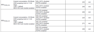

(1) I would like to know the register and setting values for disabling the output of the SDI_out +/- terminal.
(2) When SDI_OUT+/- is in disable, is it possible to make the SDI_OUT +/- terminal open?
(3) If SDI_OUT+/- can be disable with any register configuration, is the current consumption same value as IDDTRANS_EQ 205mA and IDDTRANS_CD 225mA in datasheet?

    1). Please refer to the LMH1297 programming guide section 3.15.3 for the recommended settings.
    2). Yes you can leave these pins as NC(No Connection) when SDI_OUT is disabled through pin or register.
    3). Yes your understanding is correct.
